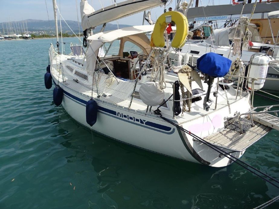

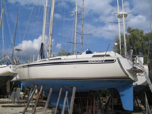

Thanks for replying. Here are some stock images, for reference. I hope they make it a bit clearer.
That makes it clear., though I have never seen it before on a Moody.
Sometimes added to protect the quarter of both GRP and wooden hulls from damage maybe when entering or leaving a marina pontoon berth, or stern-to mooring. May also protect against mooring line chafe to hull.
However if needed it may be fitted to both quarters.
Not really structural just damage prevention.
Similar protection more common on the stem to protect against damage from bow anchors.
Hi,
I note that a kedge is stowed on the pushpit just above the offending bit of stainless - I suspect the stainless is there to offer protection from the cable when deploying the kedge, particularly as the added on bathing platform prevents deploying it directly over the stern.
I've never seen that before. Your best route is to ask the vendor!
Peter.
Hi Joseph
I would say definitely added after purchase. We have a 34 and since getting into the Mediterranean could have done with this add on both stern quarters. We are currently in Greece and at least once a season when moored stern too on a quayside end up grinding one of these corners against the quay if someone catches our anchor or there is a very heavy wind.
It also would be invaluable to protect against the kedge anchor cable as Peter suggests.
So certainly not essential, especially if you aren't intending Mediterranean sailing, and odd if just one side, but no bad thing.
