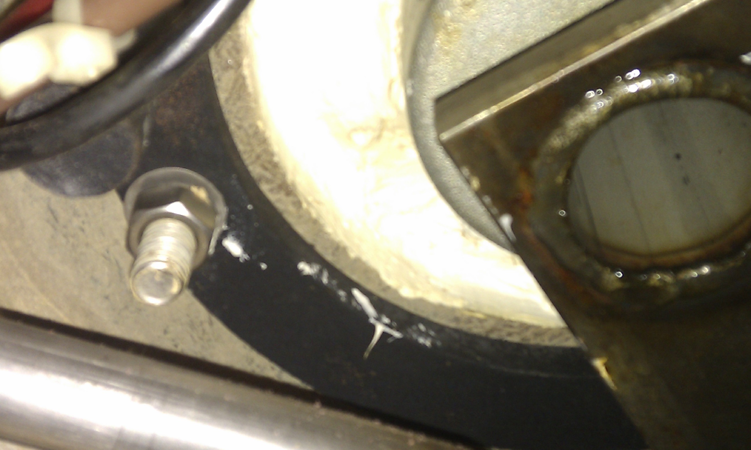

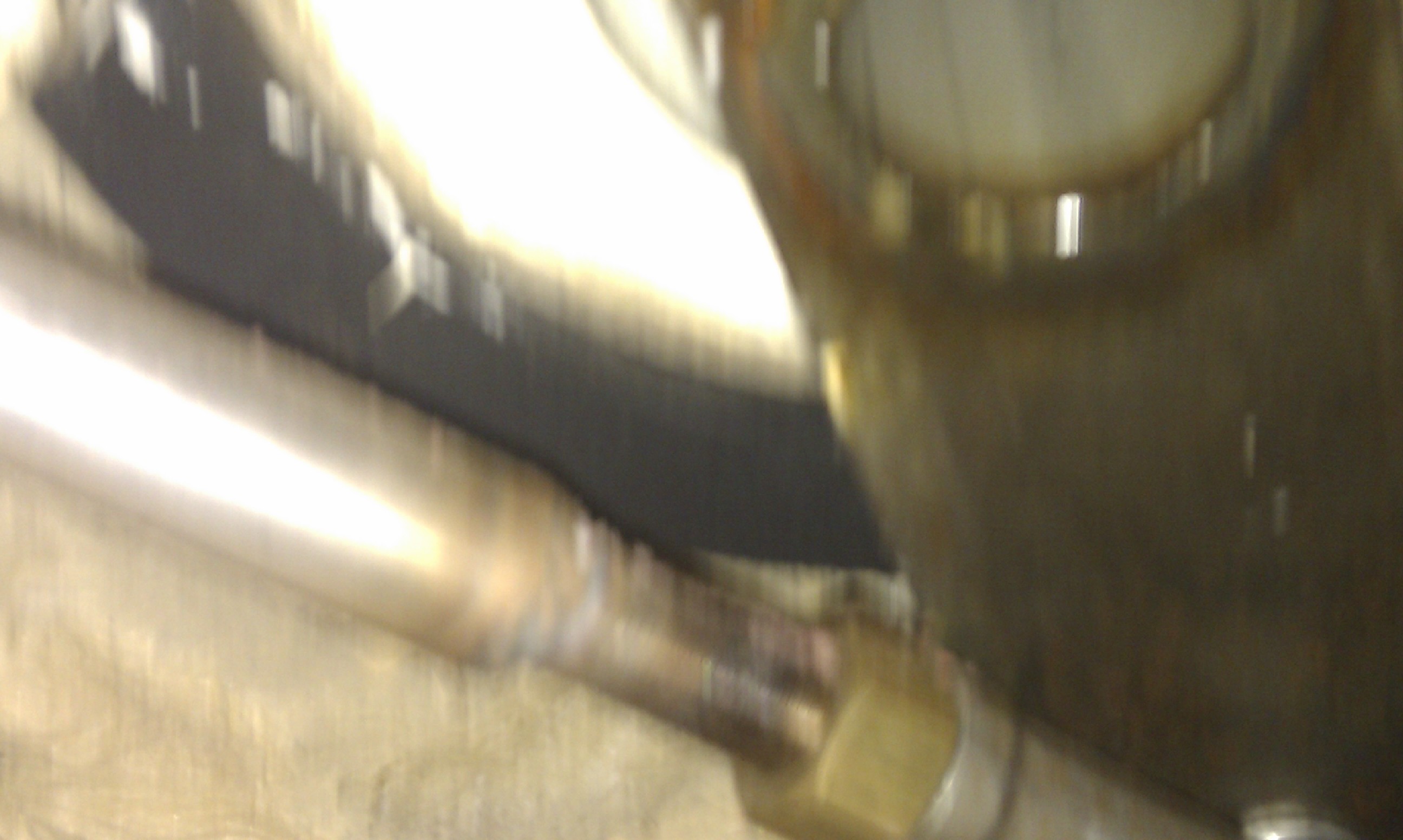

On the Eclipse 33 the two helm positions have independent linkages to the rudder post: the inner helm uses the Constellation gear: chain driven in part with a steering quadrant mounted below bunk height while the outer helm uses a robust pushrod mounted on an offset bar at the bottom of the bevel-gear driven rod running down the centre of the binnacle. The pushrod is attached to an identical offset bar on the rudder post about 1 inch below cockpit sole height. Fortunately, the autopilot drives this second, far more robust looking arrangement. The offset bars are solid steel about 1/3rd inch thick, if memory (3 yrs ago) serves, the pushrod is round steel bar about 1/2 inch diameter.
I guess Moody felt the chances of both of these systems failing was remote enough that rudder loss was more likely and therefore didn't provide for an emergency tiller. I suspect that were you to bore through the moulding in the transom you'd be able to access the op of the post with ease - it looks like the moulding was a re-use of a moulding for a design that did require the tiller attachment.
Apologies for the rubbish images, I was actually photographing for a different purpose, but you can see the bottom of the steering post descending the binnacle, the rectangular section offset bar and the round section pushrod with screw adjuster for length

Hi Paul,
Sounds like the dual helm was properly thought through in the design - each system fully redundant up to the rudder stock. The chain / cable and quadrant is probably a Constellation and the shaft and bevel gear a Cobra, both by Whitlock.
On the Constellation systems, autopilots are either wheel mounted or an independent ram which usually drives the same quadrant on the stock as the cables so, if the quadrant fails you lose both the wheel and the aitopilot. Some more meticulous owners fit a separate tiller arm for the autopilot ram, I'm afraid not me ( my excuse is that she was like that when we bought her). The quadrant is cast from some strange alloy which is fairly brittle, so a shock loading causes the C-clamp, which secures the quadrant to the stock, to break into a few pieces - I have a photo somewhere but can't get at it just now. Newer quadrants seem to be of the same material, but designed a bit more robustly, although the C-clamp doesn't look any different. More annoyingly, the newer quadrants have the stops set to allow the rudder to turn through a bigger arc so, if you replace one of the old ones without understanding this difference, your auto pilot ram will end up being the travel stop and destroy itself. Not an issud with a wheel pilot.
