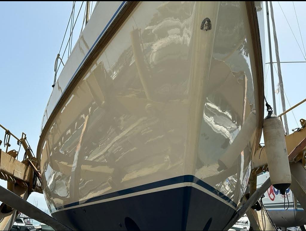

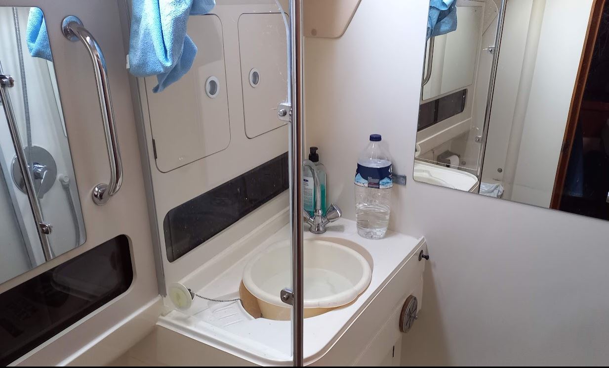

@Noel Roets funny coincident in life. We have just been visiting the very same boat. As you have already written, it is in a very sad condition. Pulling the 2 toilets out for 1 chemical toilet certainly doesn’t help it. Did you notice the backstay trim is basically rotten to one piece? We did notice the water from the leaking viewports and windows as well. Asked the broker about it, and he sort of seemed surprised. Kind of odd after reading your report. Such a shame for Moody.
We will be placing an offer way below the asked price. If you spotted something I didn’t it would be sound if you drop me a note.
Thank you in advance
Kind regards
Dennis
Hello everyone,

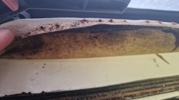

another funny coincidence.... we just visited the Moody 425 today and we are shocked. Unfortunately, we only now found this forum... otherwise we wouldn't have driven 5,5 hours to see the boat :-(
As the rainy and winter season is about to start, you can imagine, that the condition of the boat doesn't get better...

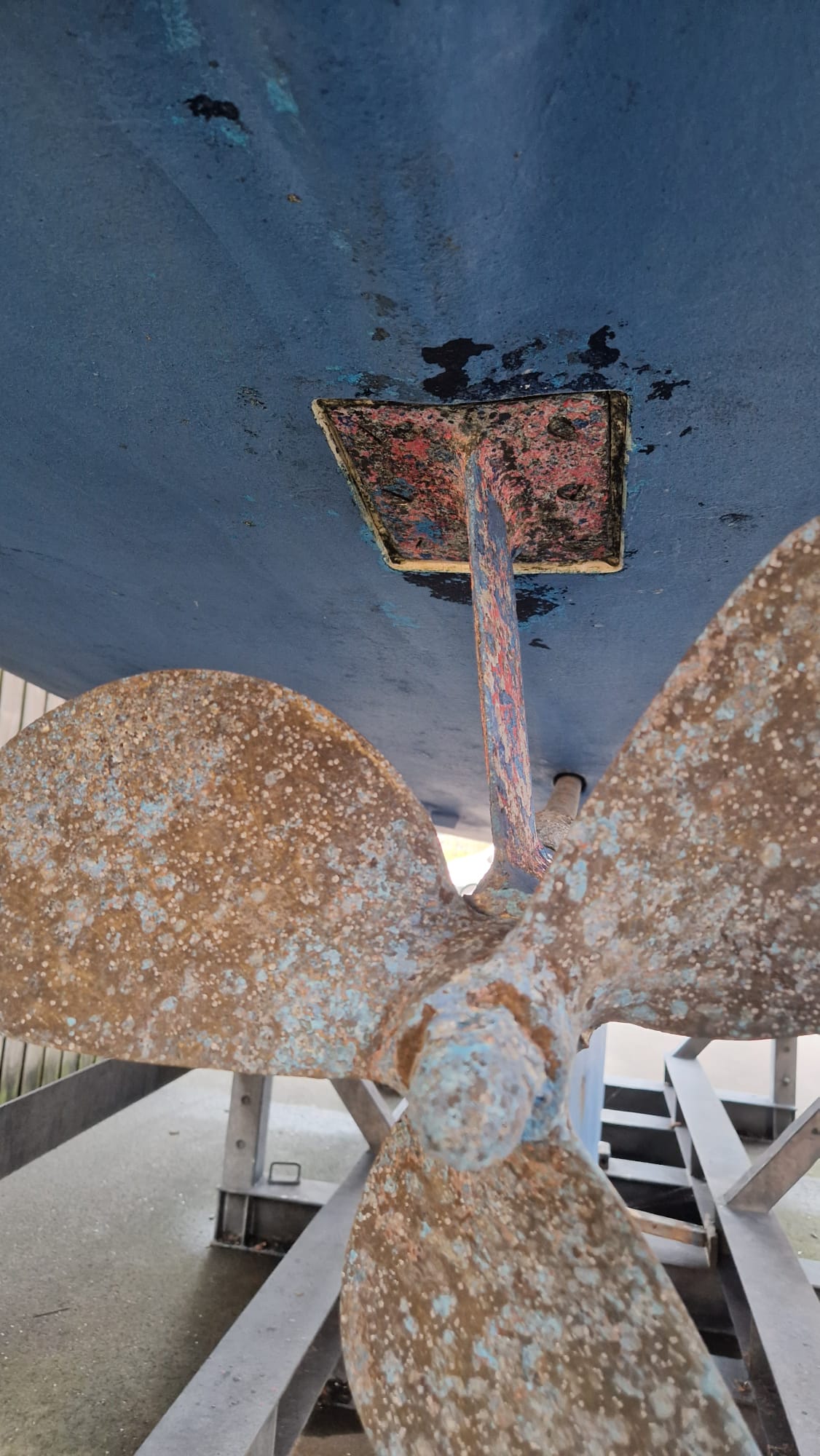

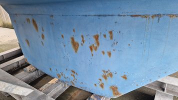

The boat is not ready to sail. All technical equipment (depth, speed, wind...) isn't working. In addition to that, for example, the fridge etc isn't working either. There is a lot of mold everywhere. The bed in the owners cabine is wet and molded. The motor and the keel are full of rust. There is a lot of water under the motorblock. Almost all the windows are leaking, the wood in the sandwich rots.... just to name some of the issues...
We'll leave the non-existent toilets etc. out of the equation ^^ (just why ???????).
It is so sad how someone can do this to his/her own boat!!!!
The broker is not very understanding, respectively the owner thinks, that it is made of gold ...? We are out.

Sad to see, but even great boats like Moodys will decay quite rapidly if not well looked after. I have often written in these pages that the value of a boat of this age has more to do with how well she has been cared for. If the balsa core in the deck is saturated, that is probably the defect that would worry me most, the rest of what is described here can probably be fixed for something between £30K and £50K, so the price needs adjusting for that. If the deck core is saturated, I'm not sure she is economically recoverable. Most boats die at some stage, just sad that this time it's a Moody which, with reasonable care, could have a much longer life.
