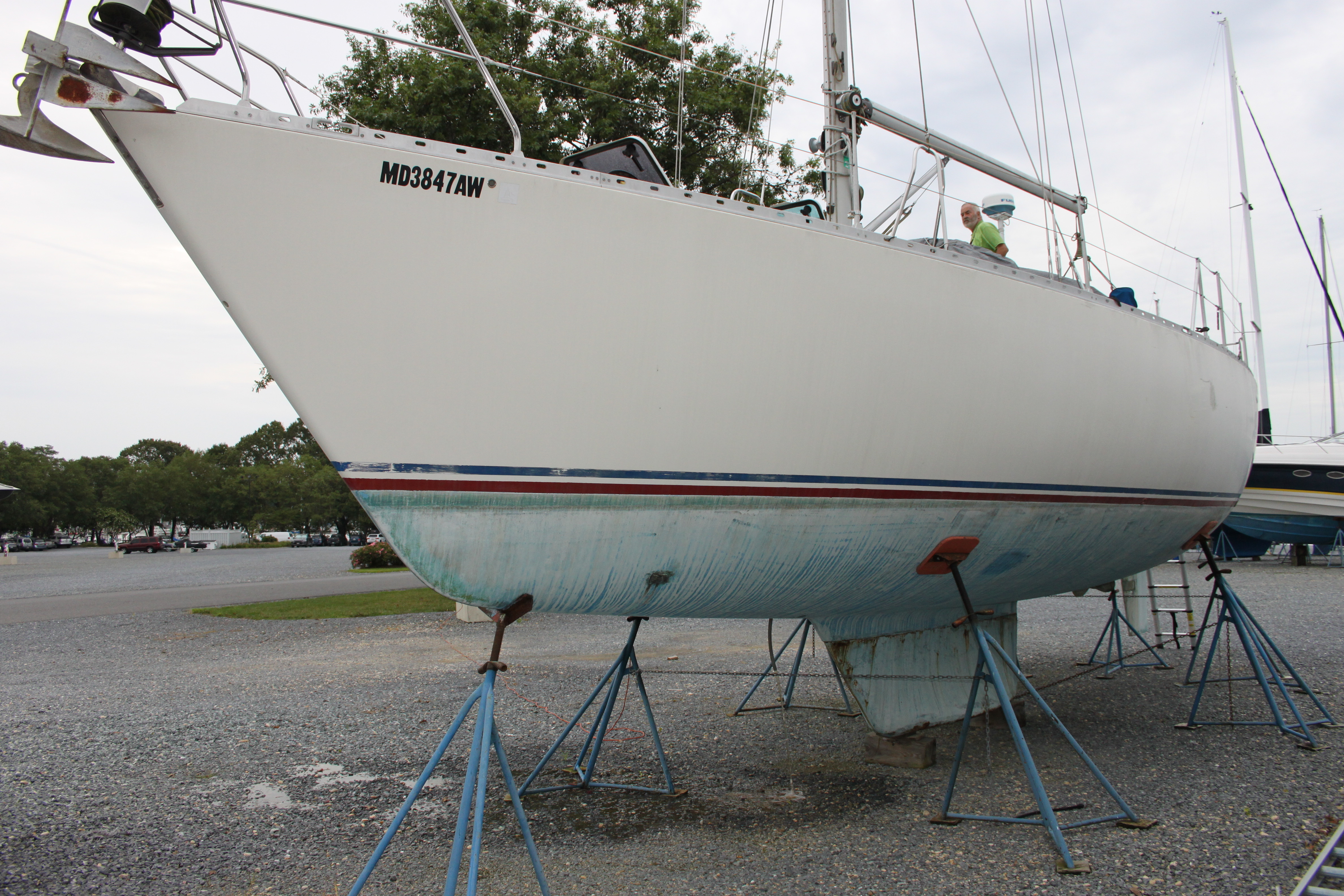

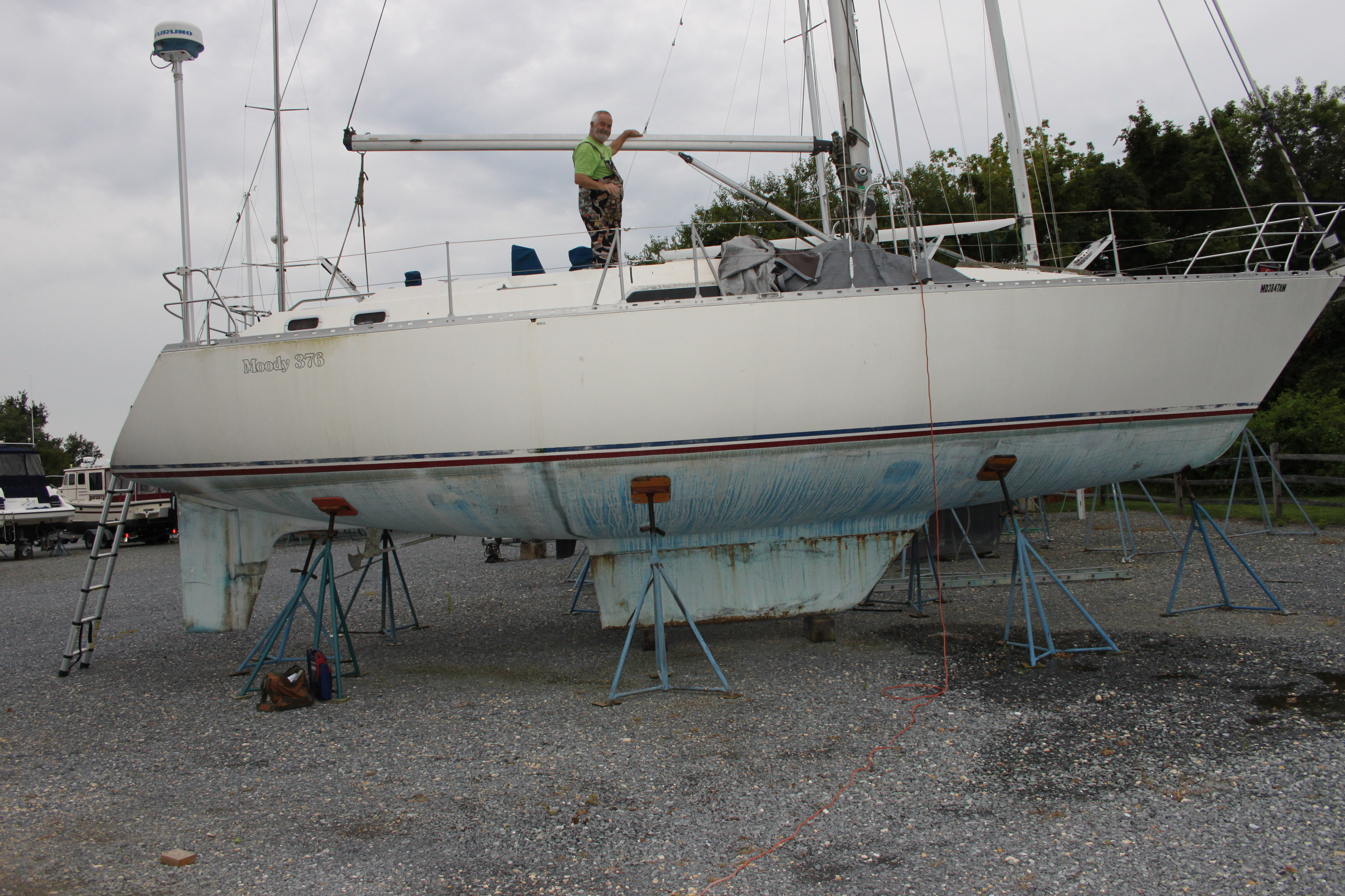

Thanks admin... I think that I'm going to have to scrape down to original fiberglass. palm sized areas of paint have flaked off. since the boats been out of the water for so long, the hull won't be getting any drier. now be a good time to put on a barrier coat? Or should I even consider it, since there are not any blisters on the hull. IE leave well enough alone. sicne ive got some areas that are flaking off I worry about the rest of the paint and adhesion
Hi Marc,
The thorough way of dealing with everything below the waterline is to have it grit blasted, but only if yu can find a contractor who is experienced in blasting grp. A good blaster will get the cast iron as rust free as is possible and leave the grp looking as though it had been rubbed down with reasonably fine wet and dry. A bad blaster will go through the gel coat in some places! (where he pauses in his movement). Once theblasting is finished, wash the iron thoroughly with a pressure washer using fresh water to get any salts out of the pores as far as possible then, if the blaster is still around, have him give another quick blast over the iron to take off the gingering. Finally, apply the first coat of a good, rust and moisture tolerant epoxy primer (this will serve for both the iron and as a barrier coat over the gel coat, but you should give at least 3 coats to have a good barrier.
Once prepared like this, you can apply your antifouling of choice or, if you don't enjoy an annual blue hair day, go for Coppercoat. It seems to me that it's a waste to use Coppercoat if it's going to be falling off with rust, so good preparation is a necessary part of the job. Here's a photo of Wild Thyme taken earlier this year - she was blasted and the Coppercoat was applied in November 2011 and is holding up pretty well. The underside of the keel was not properly prepared so still rusts a bit, not improved by ploughing grooves in the bottom of Dutch canals a few years ago.
Maintenance of the Coppercoat is to haul her out, pressure wash and burnish with Scotchbrite or similar once per year.
Peter.
peter,
port side near the bow the aft facing drain just above the water line. is that a relocation drain for the chain locker? so it doesn't drain into the bilge
Hi Marc,
Yes, it is. To be sure the cable locker would drain, rather than fill up, we had to raise the sole of the locker by a couple of inches - no real effect on the locker capacity.
Peter.
